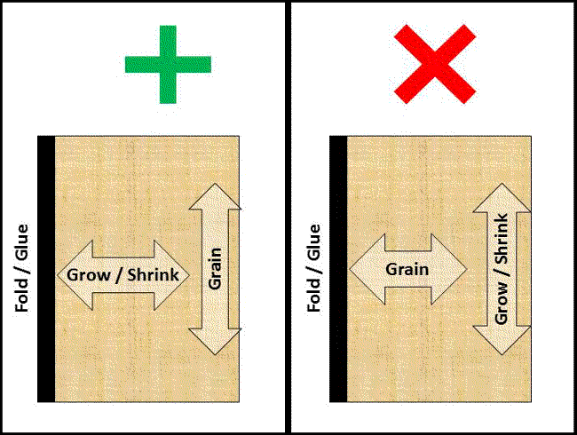

Step 4: Fold Papers in Half
Gist: Fold each piece of paper in half. Crease goes with the grain.
Detail:
  • Paper has "grain" (kind of like wood). Find the grain by gently bending the paper. It's very slightly easier to bend the paper "with the grain". See this video (the useful part is 0:50 to 1:30).
Why "with the grain"?
  • Paper grows and shrinks when humidity changes. It mostly grows and shrinks across the grain.
  • We're going to glue down the folded part of the paper. That means the fold won't be able to grow or shrink.
  • If the fold is across the grain rather than with the grain, the growing and shrinking paper will be stressing the glue and crinkling the paper.
